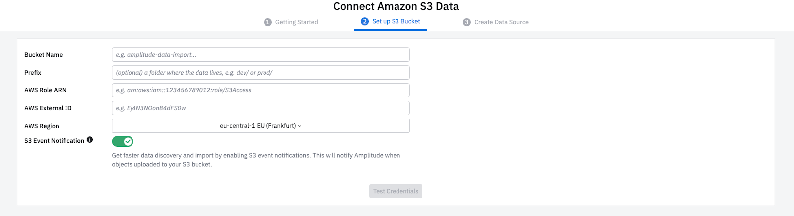

When you have your bucket details, create the Amazon S3 Import source.
  1. In Amplitude, navigate to Sources and Destinations, then select I want to import data into Amplitude at the bottom of the list of sources.
  2. Select Amazon S3, then click Next. If this source doesn’t appear in the list, contact your Amplitude Solutions Architect.
  3. Complete the Configure S3 location section on the Set up S3 Bucket page:
    1. Bucket Name: Name of bucket you created to store the files. For example, com-amplitude-vacuum-<customername>. This tells Amplitude where to look for your files.
    2. Prefix: Location of files to be imported. This must end with “/”. For example, dev/event-data/.
    3. AWS Role ARN. Required.
    4. AWS External ID. Required.
  4. Optional: enable S3 Event Notification. See Manage Event Notifications for more information.
  5. Click Test Credentials after you’ve filled out all the values. You can’t edit these values from the UI after you create the source, so make sure that all the info is correct before clicking Next.
  6. From the Enable Data Source page, enter a Data Source Name and a Description (optional) and save your source. You can edit these details from Settings.
A banner confirms you’ve created and enabled your source. Click Finish to go back to the list of data sources. Next, you must create your converter configuration.

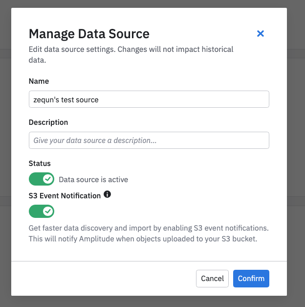

Optional: Manage Event Notifications
Event Notification lets the Amplitude ingestion service quickly discover data in your S3 bucket. Compared to the current approach of scanning buckets, it discovers new data based on notifications published by S3. This feature significantly reduces the time it takes to find new data.
Use this feature if you want to achieve near real-time import with Amplitude Amazon S3 import. Normally, new data files are discovered within 30 seconds.
Considerations
  • The IAM role used must have required permission to configure S3 bucket event notifications.
  • The bucket can’t already have existing event notifications This is a limitation on the Amazon S3 side.
  • The notifications only apply to files uploaded after event notifications have been enabled.
To enable the feature, you can either enable it when you create the source, or manage the data source and toggle S3 Event Notification.

Enable the Source
After you’ve created the S3 Import source and the converter configuration, you must enable the source to begin importing data.
To enable the source:
  1. Navigate to the source’s page, and click the gear icon to manage the data source.
  2. Toggle Status to active.
  3. Confirm your changes.
